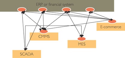

Point-to-point solutions are for small, simple, short-term interfaces or projects with a limited budget. These interfaces may be attractive to a maintenance budget but they present drawbacks. They represent a one-to-one relationship between two applications, which often leads to developing many interfaces to support information demands. Upgrading one of the paired applications requires major interface rewriting, as well as upgrading the implementation process (see Figure 2). At some point, management may find it too costly to update the interfaces and decide against further upgrades. This means missing out on features a new release offers. Other downside issues are lack of adequate documentation and the inability to reuse code. This causes IT managers to consume more overtime keeping interfaces functional.
Figure 2. Count the number of interfaces in this point-to-point example. How many connections are broken when one application upgrades?
