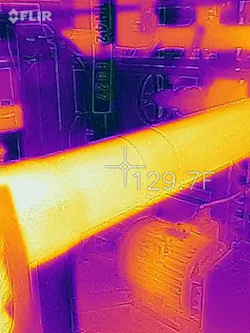

3. Thermography
Thermography is a third technology that can be implemented at a low price point and with minimal training. Two attractive options are easily accessible. The first option is to outsource a professional thermography analysis. Compared to vibrations and oil sampling, this type of study can run considerably higher depending on scope. On an annual basis however, the cost may be easier to justify, particularly for equipment like electrical infrastructure where there just aren’t many other predictive technologies available.
A more economical option is to buy a high-quality temperature scanner. Flir, for example, has an excellent camera that plugs right into a smart phone, which is also convenient for taking pictures. Data is simple to interpret and, even if you don’t ever predict a thing, you’ll be happy to have one of these scanners for everyday troubleshooting. One thing is certain: a hand-held temperature gun won’t collect dust.
