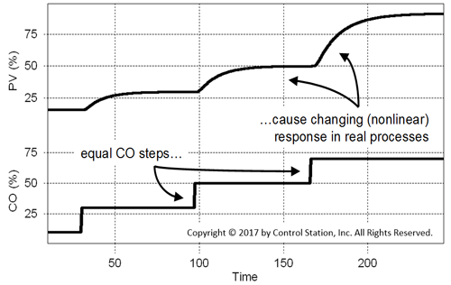

While the PID controller operates in a linear fashion, many production processes are nonlinear, and regulating their operation is not so straightforward. Think of common production processes such as flow and temperature. The nonlinear behavior of these generally is revealed as the process transitions from one operating range to another. For a given change in controller output, the process variable responds disproportionately when operated at one level of production versus another. If the process’s range of operation is extensive, then a single set of controller tuning parameters will typically struggle to regulate the process effectively. After all, the PID does have its limits.

Figure 1 – Even though the three steps in controller output (CO) are identical in size, the process variable (PV) can be seen to respond differently to each one. This is the behavior of a nonlinear process.
