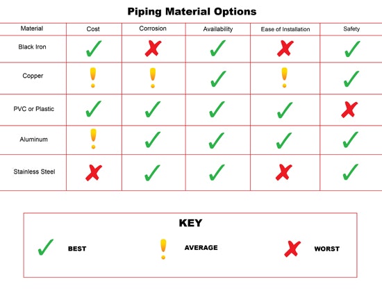

Pipe type hype
Multiple options exist for pipe material: black iron, copper, PVC or plastic, aluminum, and stainless steel. While there is nothing exciting about black iron pipe, it is commonly used for compressed air despite availability of better alternatives. Black iron hosts the compressed air in a moisture- and oxygen-rich environment, accelerating corrosion and ultimately creating a nasty combination of scale and/or sludge moving through the piping system – this is harmful to valuable and sensitive production equipment. Laminar flow is interrupted and pressure drop is created with the turbulence. Some operations go with copper or even a composite such as PVC as an alternative. There are inherent safety risks associated with PVC when applying it to compressed air; the piping can become brittle and shatter.
Aluminum is noncorrosive and has reasonable acquisition costs. Many suppliers sell aluminum pipe that is designed specifically for compressed air applications. Diameters up to 10 inches are available. Aluminum pipe has smooth bore for low resistance and low pressure drop and is corrosion-resistant. It also is light and easy to work with and has simple connections for faster installation. Often, aluminum has a higher initial investment but lower installation costs as compared with other materials.
Finally, the solution with the best qualities for efficiency and corrosion resistance is stainless steel, but it is often cost-prohibitive both in material cost and in the cost of installation.
