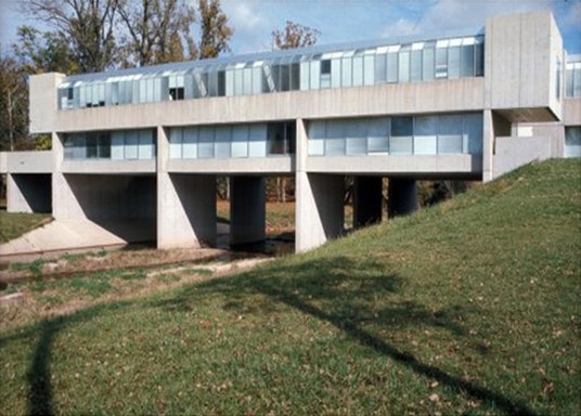

The building had won several awards for architectural design. Built like a bridge, it spanned the creek below it. From a thermal standpoint, however, spanning the creek meant that all sides of the building were exposed to the elements: not only the walls, windows, and roof, but the underside also. The building was long and narrow, 200 ft x 50 ft, with 30,000 square feet on three floors.
The long north and south walls were mostly glass and were oriented east to west. There were more than 7,000 square feet of single-pane windows in aluminum frames mounted on uninsulated concrete walls. Half of the windows were on the north side, and half were on the south.

Unknown to us, the occupants had experienced terrible comfort problems from the first day the building had opened. As soon as we started working there we discovered the night staff wearing winter coats in the middle of the summer. They froze in the winter and burned up when the sun hit the south windows in both summer and winter. Half of the building was an in-patient facility; people needing help lived in those conditions 24 hours a day.
A single loop of hot water radiators ran completely around the perimeter of the building, both first and second stories, under all of the windows, facing both north and south. There was one thermostat in one room on the south side of the building that controlled the perimeter heating loop.When the drywall had been installed during the building construction, a workman had accidently pinched the black pneumatic tubing closed that ran to that thermostat. This resulted in the perimeter heat going into “full heat”, its fail safe or freeze protection mode.
It had been running full out since the building was built, 24 hours a day, 365 days a year, summer and winter for nearly 10 years. This resulted in the air conditioning system running 24/7, 365 days a year to attempt to remove the excess heat. The heating and cooling systems were fighting each other to try to maintain comfort.
How could this problem have been missed by everyone associated with the mechanical system during that time? I wish I knew. But by spending enough time in the building and being responsible for both comfort and energy costs, we found the problem using basic problem-solving techniques. Nearly 40 years later, I clearly remember tracing the tubing above the ceiling, down the wall and finding and fixing the problem.
