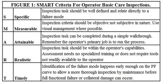

Building a successful operator driven reliability program takes more than just asking operators to go and inspect their equipment. Many operators are not adequately trained on basic maintenance troubleshooting techniques. They do not understand the cause and effect relationship between the symptoms (warning signs) and the consequences (the resulting functional failure.) Remember, their primary job is to get product out the door. When a machine starts showing the first warning signs of functional failure, it still had the ability to perform its basic function. A pump with a leaking mechanical seal is still capable of moving product from Point A to Point B. Operators, in a culture where the reactive running mode is the norm, learn to ignore the warning signs, make due, and wait until full functional failure before writing notifications. “If it’s not broke, don’t fix it” rules the day. If you want operator-led inspections to improve your overall equipment reliability, I suggest you develop inspection PMs using SMART criteria. Figure 1 shows the definition of each letter in this mnemonic acronym SMART and my own examples of how each letter’s definition relates to the inspection task.
I cannot stress the importance of having inspection tasks be both “Specific” and “Measurable”. The inspection task should be “point specific”, not generic in nature. The “point specific” task should directly address a known failure mode. If your PM says: ‘check pump’, the inspection comments you receive back very well might say‘pump OK’”. So write your inspection criteria as specific as possible for improved results. Take the following inspection task: Check whether a rotary dryer trunnion bearing is receiving adequate lubrication. If the task states, “inspect lubrication on trunnion bearing”, you might get several different answers and any notification that is written will be more opinion then fact. But if your inspection task is “point specific”, and instructs the operator to count the number of drops of oil dripping on the trunnion in a given time interval, you will be making a specific request and receive a specific answer. If the task further asks the operator to determine whether the oil is being evenly distributed across the trunnion’s surface and provides an explanation illustrated by two pictures; one where the oil film was uniformly colored across the surface (an acceptable condition) and one where a tell-tale darkening or discoloration occurred on one end of the surface indicating a potential misalignment issue. This “point specific” task addresses a specific failure mode. Training the operator to write a notification requesting that maintenance check the trunnion for misalignment if the second condition is observed, closes the loop and creates a value added inspection task. You have now created a specific inspection task which gives you early signs of a failure mode (misalignment) before full functional failure, and collateral damage, occurs and a procedure where the notification requests a specific corrective action by maintenance. Do you see the added value of this approach?

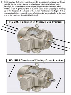

Visual management plays a big role in teaching operators “point specific” inspection and corrective action techniques. I learned that introducing too many new concepts at one time overwhelms people. Inspection techniques should be taught in what I refer to as “single point lessons”. Single point lessons teach one concept at a time using simple language and pictures which clearly illustrate the desired technique.  Laminated single point training lessons are a great way of getting the desired objective across. Refrain from using “Engineering Speak” when writing single point lessons. Operator driven reliability PMs should include simple corrective actions the operator can complete during the inspection along with the failure identification tasks you desire. I can distill equipment reliability down into one simple sentence. Keep heat and dirt away from the machine, keep the machine clean, and keep it from vibrating. Sounds simple, but if the corrective actions taken by the operator during his rounds help accomplish these objectives, you will greatly extend your equipment life. Figure 2 illustrates the proper cleaning techniques used to remove material from around a motor.
