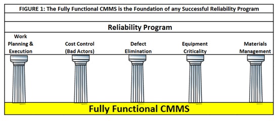

I have heard many people say that SAP is not a good choice for a CMMS, but I believe a successful CMMS implementation has less to do with the system you choose and more to do with the effort you put into getting the most out of what you have. Like an ancient Greek temple, a fully functional CMMS provides the firm foundation on which the pillars of your reliability program are built. Work planning and execution, equipment based cost accounting, bad actor identification and resolution, defect elimination, equipment criticality, and best practice materials management are all supported by a fully functioning system.  Without a fully functional CMMS, your program will crumble.
