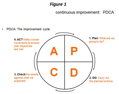

I have found that a program element has a greater chance of success if it is laid out in advance in a stepwise fashion. Our reliability strategy has 29 program elements and they are grouped as beginning, intermediate, and advanced activities. Most of the elements which make-up our program are fairly common and are considered by most as generally accepted industry practices. Success is not achieved by stumbling across some secret formula others have not tried. Results are created by the thought process, intent, and effort which go into the development of each program element. Those who succeed just work harder than most of us, there are no magic bullets.  As I stated earlier, certain program elements act as precursors to others, and should be among the first you roll out. Timing and sequence are all important; getting too many initiatives started at the same time stymies culture change; rolling out program elements in the wrong order can doom the program to failure. Each program element should be developed with what I will call a Plan, Do, Check, Act or PDCA action cycle. (See Figure 1).
The PDCA action cycle is an effective method to build your program, and those organizations which thoroughly map out their strategy, usually achieve the best results. I will explain the PDCA action cycle in greater detail in the following chapters.

Careful planning leads to better execution in the “Do’” phase and helps establish the timing for each step in the program rollout. As an example the RCFA triggers must be established, documented, and communicated to all responsible parties. Training must be completed so that operators and front line supervisors will recognize a triggered event and mechanics will save parts such as belts and bearings, preserving each item in their “as found” condition so failure analysis can be completed. Strategic planning leaves fewer things to chance and increases the probability that your program will meet its goals and objectives. When your initiatives are well planned and predicted results are achieved, you build credibility and give the perception that you are competently managing the program.  The result: people will be more apt to support your initiatives in the future and your program will flourish.
The KPIs you develop in the “Planning” phase act as the “Check” step in the action cycle. I like to establish what I call results based and behavioral based KPIs for each program element. Results based KPIs measure program payback while behavior based KPIs measure program planning and execution effectiveness and stakeholder buy-in. While the second set of metrics is somewhat soft, both are equally important measures of success. In our example, establishing a RCFA program, the obvious results based KPI might be future cost and production loss avoidance by completion of the action items or findings developed from the RCFA. We had one fairly critical fan on a spray drying system where five bearing failures occurred in a two year period. After completion of several action items, the fan went four years without another bearing failure and that failure was caught early enough on the PF curve so that collateral damage was avoided and production loss was held to a minimum.  While results based KPIs are essential to communicate program success, behavior based KPIs can also be established and used to determine whether the actionable steps completed in the “Do” or execution phase of the PDCA action cycle were effective. A behavior based KPI might be the measurement of the number of triggered events where the evidence was preserved and the initial investigation was completed by the front line supervisor. A high % of compliance indicates the stakeholders know their role, have bought into the program, and are fulfilling their assigned duties. Remember, some of the events will occur in the middle of the night on a Saturday evening, while the reliability engineer who will eventually be assigned the RCFA when he or she comes in on Monday, is sleeping. If the evidence ends up in the scrap dumpster and the crime scene is cleaned up before the investigation starts, the chances of finding the root-cause are greatly diminished.
The final phase in the PDCA action cycle is the “Act” step. This is the step where you monitor the program roll-out and determine whether all of the executable steps have been completed, the initial goals have been reached, and the calculated payback has been met. Any course corrections necessary to get your program element back on track can be made at this time. An illustration of how the “Act“ step might be used in our RCFA program roll-out could be if the number of triggered events exceeded the available hours that the reliability engineers assigned to the program had available to facilitate the analyses. An act step might be to assign a third reliability engineer to the program if one exists or to raise the trigger threshold of events to reduce the number of RCFAs generated. Either way, the “Act” step can be used to develop a continuous improvement loop, forcing a whole new series of Plan, Do, Check, Act steps.
