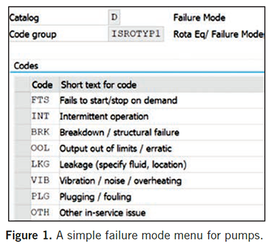

A notification is meant to identify and communicate a defect – an actual or impending operational failure condition – requiring maintenance action. This central component of a notification is left to chance, however. The blank canvas of a free text field does not provide the structure needed for success. No combination of training, instructions, reviews, and cajoling is going to overcome the power of this blank space to ruin data quality. Consistently good notifications require standardized failure mode choices in the form of a menu.
This use of “structured data” gives users a starting point and a framework of “buckets” in which to group and categorize their notifications. Structured data enables data analysis over time, as well as a consistent and concrete way to categorize notifications for gatekeeping and planning. It also helps users create a better narrative description in the free text fields by giving them a starting place to guide their diagnosis. For example, health care professionals have found that the Electronic Health Records doctors use to document and communicate their diagnoses are most effective with a similar combination of structure and free text fields.
The good news is that most computerized maintenance management systems (CMMS) already have a failure mode field that can be customized to fit your needs. Thus, any attempt to standardize notifications must start with a manageable list of failure modes. The menu should cover the roughly 80% of issues that we see repeatedly in the normal universe of routine maintenance.
ISO 14224 and IEC 60812 provide comprehensive lists of failure modes as a starting point. In practice, we recommend simplifying these lists to roughly eight broader categories. Don’t over-engineer your taxonomy of failure modes for the notification process.  We’re not trying to automate the root cause analysis process.
Furthermore, the menus should be customized by the selected equipment type. A single menu would have too many options – and many that do not match the selected equipment. On the flip side, we cannot have menus customized to every pump type, model, and manufacturer. A good approach would be to create customized menus for the 23 equipment classes found in ISO 14224, noting that not all 23 classes will apply to every plant. Figure 1 provides an example of the resulting menu for a pump.
This approach offers several benefits. First, it provides the notification initiator with a concrete framework in which to work. At a minimum, selecting a failure mode provides more information than “pump broken.” Second, it provides engineers with structured data that can be analyzed to improve asset reliability.
Third, and most usefully, using standardized failure modes to write notifications provides concrete data in order to prioritize work and to identify the proper, repetitive maintenance action, which can be standardized to improve work management efficiency and effectiveness. Notifications can be explicitly linked to the appropriate standard job plan.
