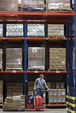

You might see reach trucks being used for horizontal transport, which could be done more cost-effectively by a pallet truck. If your reach trucks spend a lot of time in the dock area moving pallets or transporting products from one place to another, it might be possible to trade in some of your reach trucks for pallet trucks. The better lift truck dealers would be willing to arrange a trade-in plan. Walkie pallet trucks are more economical than reach trucks in terms of both purchase price and ongoing maintenance. Switching to a more economical transportation truck can quickly reduce lift truck costs and expenses over the life of the truck.
