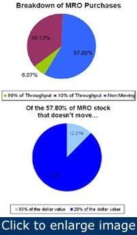

Figure 1: Only 6% of typical MRO inventory makes up 90% of throughput and 58% essentially doesn’t move. Typically, 80% of the value is concentrated in 12% of this stagnant inventory. (EquipNet)
The average turnover of MRO inventory is a year or more, so at least half of it is commonly considered inactive. Only 6% of typical MRO inventory makes up 90% of throughput and 58% essentially doesn’t move (Figure 1), according to reallocation and liquidation company EquipNet (www.equipnet.com). Typically, 80% of the value is concentrated in only 12% of this stagnant inventory.

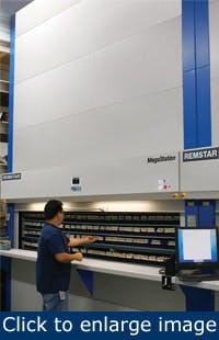

Figure 2. Atlantic Transportation in Washington, D.C. moved a 12,000 sq.ft. spare parts department into 1,500 sq.ft. by storing 99% of its 100,000 parts in four vertical storage units.

Large-scale automated storage and retrieval systems (Figure 3) can save floor space or increase storage capacity, allowing plants to consolidate or combine facilities by packing more into a smaller footprint. Automation software can control access with open and secured trays on the same unit. Some are available to all, some only to managers without a separate area for security.
“Everything is delivered waist-high so there’s no walk-and-search, less strain, fewer injuries and less training for new or temporary employees,” says Ed Romaine, vice president, marketing, Remstar (www.remstar.com). “No more flood of people waiting for what they need.
“ROI of nine to 18 months is typical, by saving the time of well-trained people walking around to find something. Instead, they can log onto a PC in a manufacturing cell to request an item, and it’s ready when they (or a runner) come to get it.”

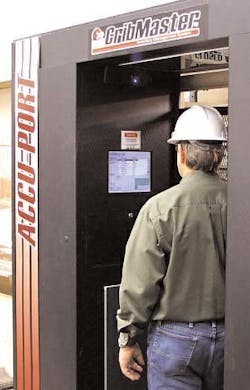

Vending machines can keep parts, materials and special tools close to the work. A kit might be a list of items to collect at the time of issue, or preassembled in a single location. “Either way, once the kit information is imported into the software, it can vend the entire kit with a single command,” says Holmes. “A helix machine can spit out the parts.”
Figure 3. Like a hotel mini-bar, vending cabinets with RFID and scales can keep track while technicians freely access tools and materials without slowing down. (Cribmaster)
When tools are stored in vending cabinets (Figure 3), software can track tool returns, sharpening or calibration. “You might have an RFID cabinet with a green side and a red side — you scan the work order to open the cabinet, take the tools and materials from the green side, and return tools to the red side,” Holmes adds. “The software notifies when returns need to be processed and tells what needs to be done.”
