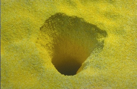

Phenomena called aching and ratholing can interrupt bin discharge (Figures 1 and 2). An arch, which is a form of stable obstruction that can develop inside a storage vessel, is usually located at, or just above, the outlet. It occurs in this location because that is where the bin cross-section is narrowest. Mechanical interlocking of particles that are large relative to the size of the outlet or particles that bond together form the arch (Figure 3). In contrast, ratholing occurs when a stable, nearly vertical flow channel empties out and the material surrounding this channel remains stagnant.
Figure 1. Material can be so cohesive that only a limited active volume moves through the bin.
Figure 2. Ratholing leads to inefficient and uneconomical storage.

Limited live capacity: Ratholing reduces the live or usable capacity of the vessel to the volume of the rathole, which can be as little as 10% to 20% of the nominal bin volume. A bin or silo in which ratholing occurs is an uneconomical storage vessel that needs to be refilled more frequently than necessary.
