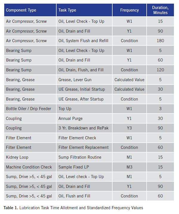

The AMRRI team, which comprises several career maintenance and lubrication management professionals, set out to establish a baseline for the many tasks that we encounter when providing a detailed lubrication plan to our customer base. Table 1 represents our conclusions for the time needed to fulfill each distinct task in the variety of industrial complexes we routinely visit. These numbers have been used as the basis for lubrication essential-care plans at multiple plant sites where we’ve created work plans. When we break a machine down to its individual sub and sub-sub components and identify related lubrication points, we assign these value(s) to the required task(s).
Following this logic, let’s consider a production department operating with a machine complement comprising five very common assets by type: air compressors (1), agitators (16), conveyors (9), fans (24), and pumps (50), totaling 100 assets. The task requirements (task type and time needed) for these five common machine types are represented in Table 1.

As we begin to aggregate the net number of task types, with each task having a time stamp and each task having a repeating interval, we can see that even a small production cell can accumulate a multitude of events each year that require scheduled attention. Table 2 shows a summary of annual hours for each asset multiplied by the instances of that asset type in the production cell.
Once task-visit requirements roll together, we can see the hours pile up. Eventually, we can articulate to management precisely what is needed to cover the lubrication task requirements for our mechanical footprint.
A rule-of-thumb estimate of seven to eight hours net requirement per asset is good enough to put one in the right ballpark, but there is no substitute for evaluating the actual operating assets, their respective complexity and operating environment, and the difficulty of accessing each asset as time goes by.
