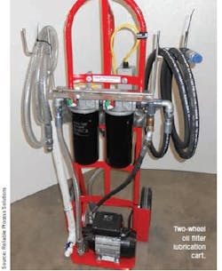

Terry Harris, president of Reliable Process Solutions, urges analysis to determine whether new lubricants are clean and dry and have the proper viscosity and additive packages. Those that aren’t stored correctly “can pick up foreign material and moisture if open containers and random jugs are used,” he cautions.
Filtration of new lubricants using mobile oil filter carts or lubrication storage room filtration and recycling equipment is a very effective and beneficial process, says Harris.
He suggests that to help keep the lubricants clean and dry, clean lubrication storage rooms with self-contained lubrication storage and filtration units be used, with IsoLink containers for transport used around the facilities. He also recommends desiccant breathers to help keep particles and moisture out of operating equipment that starts and stops often and/or is situated in a dirty or humid area.
