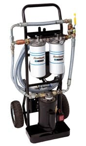

Figure 4. Portable filter carts are one of the most versatile and effective tools available for lubricant transfers and decontamination. Source: Des-Case Corporation
It really doesn’t matter how well you filter new oil if you dispense it into a dirty container. Several acceptable options exist for delivering oil to machinery, and some are better than others. For large and moderate sized systems, the best method is usually to pump oil directly into the sump from a drum or tote using a filter cart (Figure 4). Portable filter carts are one of the most versatile and effective tools available for lubricant transfers and decontamination. When using filter carts, make sure you use the right fittings on the equipment sumps to make the fluid transfer or decontamination efficient and effective.
Additionally, consider using units that are dedicated to specific oil types, in order to prevent cross-contamination of lubricants and avoid the labor intensive process of flushing carts to switch products. Some manufacturers allow you to color-code your filtration unit to help identify which cart should be used with a particular lubricant. As a side benefit, most users find that performing an oil change with a filter cart only takes about half the time as performing the job with conventional methods.
