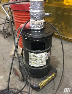

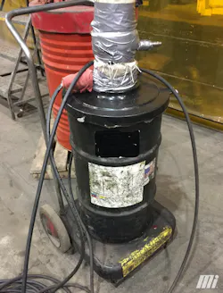

  • refilling smaller drums (re-packaging for convenience) from larger containers (Figure 2).
I often observe lubricant drums with water overflowing the drum cover, or the lid rusted from previous water exposure. Usually, the contaminant is introduced into the system when filling reservoirs or prefilling the system. Open ports on components, hoses, tubing, and fittings during handling while installing is an invitation for dirt to enter the completed system. Take proper care when handling any lubricant, for the health of the system and the lubrication point. Why lubricate a rolling element-type bearing with contaminated product?
Figure 2. This keg was refilled multiple times, introducing dirt. (Photo: Motion.)

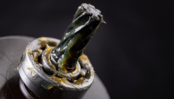

Grease as a lubricant
If a grease product is needed, filtration becomes more difficult. Because grease contains a thickener, a strainer should be used with a 40- to 60-mesh size. A 100-mesh strainer can occasionally be used, only after consulting the grease supplier or manufacturer. Mesh elements that are too restrictive can separate the thickener from the base oil. The thickener will appear as a wax-like substance in the clogged element.
The remaining oil without the thickener may proceed past the plugged element to the lubrication point but will not be adequately retained; instead, it will drain out of the point. In any case, a heavy-duty element must be used, so it does not collapse during high-pressure differential caused by element blockages. Collapsed elements not only allow non-filtered product to pass, but the particles trapped by the failed element also flow downstream, along with materials of that element. Generally, the grease supplier or manufacturer should be consulted to ensure the product can be used under pressure in a centralized lubrication system. Grease separation is often observed in system components, causing system failures.
