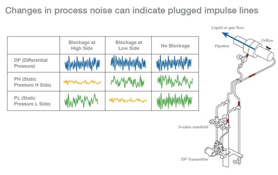

Some smart instruments are able to detect deterioration in a key component or realize sensor drift. Others look at the process and might spot changes. For example, a differential pressure sensor can measure process noise and determine the normal level (Figure 1). When the noise level begins to fall or differences emerge between high and low readings, it may signal a problem with impulse line plugging. Such plugging can mask the true pressure differential and result in an unreliable reading. Today’s smart instrument can send a warning when they begin to notice such changes.
Figure 1. By monitoring process noise, a pressure sensor can determine if impulse lines are plugging. Differences between the high side and low side suggest one of the lines is becoming obstructed.
