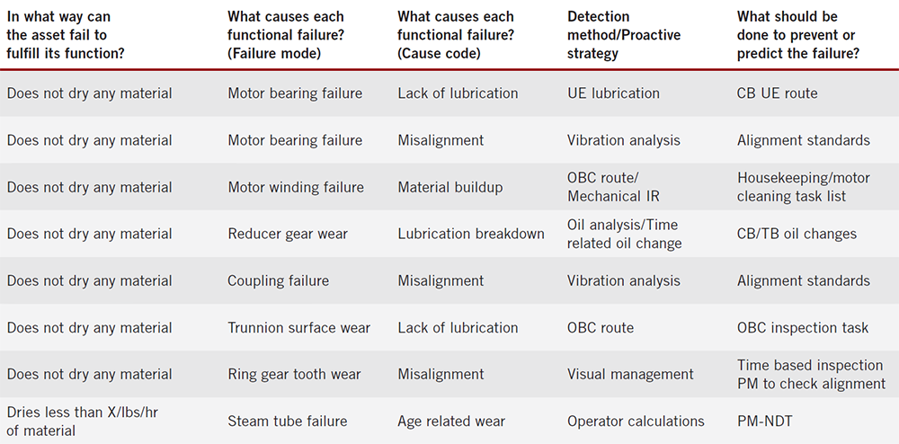

At my facility, we use a streamlined approach which I call FMEA Object Type Templates to capture the most common failure modes and cause codes for a given asset class. In this way, the primary failure modes/cause codes can be identified for the entire asset class holistically, so SMART maintenance strategies can be quickly established and implemented factory wide. Figure 1 shows an excerpt of the FMEA Object Type Template completed for the rotary steam tube dryers for our site.
Notice columns four and five in Figure 1.  Column four identifies the detection method or proactive maintenance strategy used to address the failure mode/cause code.
Figure 1. Example of Partial FMEA - Rotary Steam Tube Dryer
You will see that both condition-based and time-based maintenance strategies are identified, with time-based strategies being assigned to both operations and maintenance personnel. Column five defines the specific task which will be assigned to address the failure mode. Once the appropriate strategy and executable tasks have been chosen to best address the failure mode, one can apply SMART criteria to ensure the inspection and executable tasks produce meaningful results (i.e., costs are reduced and downtime is decreased).
