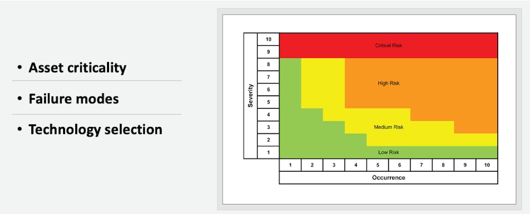

1. Establish an asset health management database
Start by establishing an asset health database to document and prioritize equipment. Building out a database of your assets and equipment, including asset criticality, failure modes, and tools to inspect with, is a good starting point to improve any maintenance program. Leverage your computerized maintenance management system (CMMS), OEM guidelines for operation and maintenance, as well as applicable industry standards to determine the method and frequency of asset condition monitoring inspections (see Figure 1).

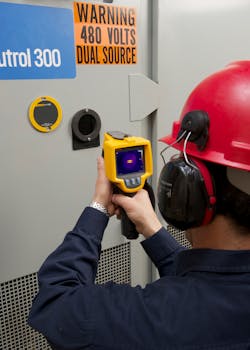

5. Use and install the right thermal imaging tools
Thermal cameras are non-contact tools designed to be used from a distance, allowing you to remain outside of an arc flash boundary or other unsafe condition whenever possible. Where that’s not possible, thermal imaging accessories like accessory lenses and IR windows can give you the access to inspections with an additional layer of safety.
  • Lenses. Some thermal cameras allow for interchangeable lenses. Tailor the view you want by switching to a wide-angle or telephoto lens.
  • IR Windows. IR windows are permanently installed into the side of a panel to provide a means to view inside and capture thermal images of important equipment without exposing workers to dangerous live voltage (see Figure 2). This both improves safety and creates a more consistent process to assess the asset. Because of the permanent nature of the window, a thermal camera can be positioned consistently, enabling you to build a baseline and a trendline as well as a collection of images showing the asset.
