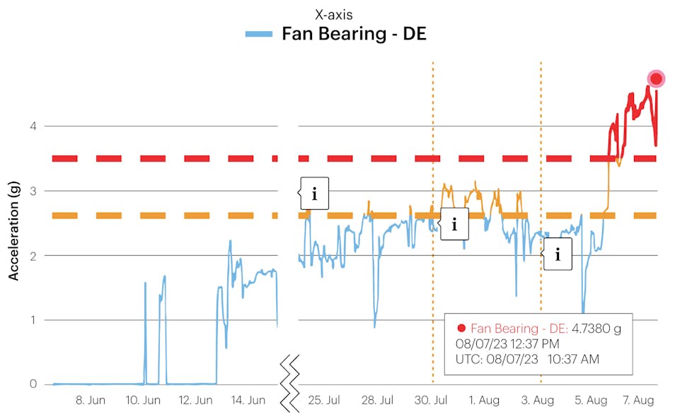

An indication through vibration analysis of inadequate lubrication is called haystacking. In a fan application, the graph would show increased amplitudes between 2,000 and 3,000 Hz before lubrication and then a significant decrease in amplitudes after appropriate lubrication is applied. Another example of a bearing requiring attention from inadequate lubrication is shown in Figures 2 and 3, an overall acceleration chart and a 3D FFT chart, respectively. The fault identified was categorized as a dry bearing which triggered a re-lubrication event.

Concluding with a business case, here are the financials of a single-bearing issue caught and resolved before failure could occur—based on the data shown in Figures 3 and 4:
Type of failure: Lubrication
Cost avoided: $19,000.00
Downtime avoided: 8.00 hours
