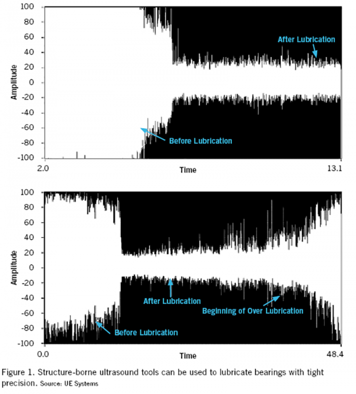

4. Mechanical efficiency and friction
Friction is both a good friend and a dangerous enemy. As the saying goes, it’s important to keep your friends close and enemies closer. Friction is the ultimate source of ultrasound, so it is vital to keep a close relationship with friction. While friction is important to pinpoint the exact issue occurring, too much friction can: create excessive heat, contribute to energy loss, utilize a greater amount of power to overcome, cause expansion, cause a bearing or sliding surface to fit tighter, and much more.
Some of the biggest culprits of friction are over and under lubricating bearings, using contaminated lubricants, or using the wrong bearing type entirely. Figure 1 shows how structure-borne ultrasound tools can be used to lubricate bearings with the precise amount of grease necessary.
