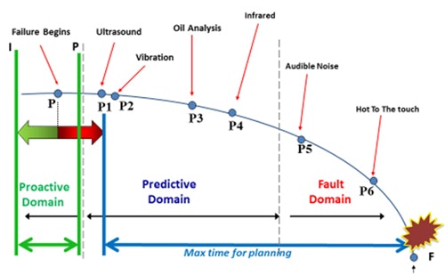

Airborne and structure-borne ultrasound has certainly become a major player in condition monitoring. Once considered just a leak detector, more maintenance and reliability professionals are realizing the benefits associated with using ultrasound for condition monitoring applications, and the I-P-F curve with which we have all become familiar with reflects that trend (Figure 1). We must be concerned not only with the P-F interval, once a failure has been detected, but also with the I-P interval. The I-P interval is where precision maintenance is used to ensure that the equipment is being installed properly using precision balancing and alignment and installing the bearings properly. Precision maintenance is achieved when ultrasound is used to prevent over- and underlubrication of bearings, thus helping to extend the I-P interval.
Figure 1. The I-P-F curve shows ultrasound as being the first technology that detects a failure that is mechanical in nature, such as early stage bearing wear, or subsurface bearing fatigue. Precision lubricating bearings with ultrasound helps to extend the I-P interval.
