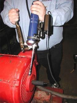

Generally speaking, when the amplitude of a bearing exceeds 8 dB and there’s no difference in the sound quality established at baseline, the bearing needs to be lubricated. To prevent potentially disastrous over-lubrication, the technician will then apply lubrication, a little at a time, until the dB level drops. Many departments set up their condition-based lubrication programs by incorporating a two- stage approach. The reliability inspector uses a relatively sophisticated ultrasound instrument to monitor and trend bearings. A report of bearings in need of lubrication is produced. The lube technician then uses a specialized ultrasound instrument that alerts the technician when to stop adding grease. These instruments can be affixed to a regular grease gun or worn in a holster (Figure 2).
{pb}
Figure 2. Many departments set up a two-stage condition-based lubrication program. The reliability inspector monitors and trends bearings and creates a report of bearings in need of lubrication. The lubrication technician then uses a specialized instrument to tell him when to stop adding grease.
