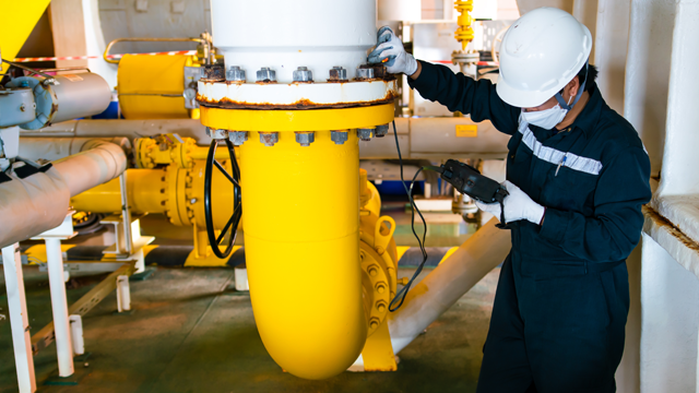

Ultrasound technologies are proliferating in more and different applications. Whether detecting early signs of equipment failure or asset flaws, or refining measurement accuracy or cleaning effectiveness, ultrasound solutions are becoming increasingly indispensable.
