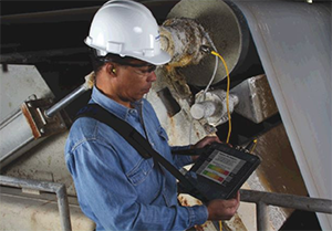

Figure 1. The data-collection chain — comprised of the sensor, sensor cable, and a portable analyzer or continuous monitor — is the source of route-collection data.
Ensuring proper analysis of machinery or asset conditions begins in the field with data collection. The sensor is the beginning of the data-collection chain (see Figure 1), which also includes the sensor cable and the device into which the sensor is collecting data – a portable analyzer or continuous monitor. Proper sensor selection, placement, and mounting onto the machine to be monitored is critical to having valid data for analysis.
Configuration of the data channel is also critical. One must be aware of the data expected to be captured. Accordingly, the person configuring the data channel should set parameters such as maximum frequency, lines of resolution, and number of samples (if averaging). If these first steps are not planned well enough, there is a risk that the collected data will not be ideal for asset analysis.
When using a portable analyzer, alarm limits and other notifications are often available as a part of the route definition loaded in the analyzer from the software. This allows the data collector in the field to identify any measurement points that may have exceeded the set alarm limit. Evaluating asset condition while still standing near the asset in the field is ideal. Less-than-ideal is noting the potential anomaly after returning to the office and then making an extra trip back to the field for additional data collection and possibly other data parameters, such as phase.
Some portable analyzers offer embedded expert analysis tools that allow even the less experienced analyst to achieve masterful results while collecting data. If someone else plans to analyze the data, then the collector technician can note the preliminary field analysis to provide the analyst with in-field observations and opinions from the data collector.
