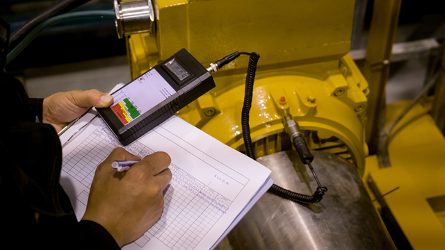

Industrial assets benefit from proactive condition management. Vibration monitoring and analysis are prominent predictive maintenance strategies, and vibration damping is a foundational vibration control strategy. Solutions that deliver on these strategies help plants to detect or prevent irregularities, avert costly failure and downtime, and increase reliability and efficiency.
Monitoring technologies
Vibration monitoring of rotating equipment reveals issues before they create problems. The new SM series accelerometer from Wilcoxon Sensing Technologies is a side-exit vibration sensor. Its integral cable and optional armor remove the need to install a separate cable assembly, and protect the sensor and cable in wet and aggressive plant environments.
