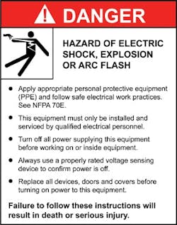

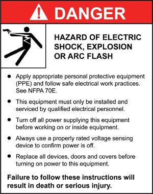

NEC labeling requirements
NEC Section 110.16 requires labeling that provides a general warning against arc-flash hazards. Changes to the NEC labeling standard have been made with subsequent revision cycles (2005, 2008, 2011, and 2014). NEC labels should contain "signal" words, colors, and symbols and should comply with ANSI Z535, which has been adopted by OSHA. Messaging should include specific details on:
  • The nature of the hazard
  • The consequences of the hazard
  • Avoidance procedures
NEC labeling requirements also are referenced in Section 110.21(B). Because NEC labels do not contain circuit-specific information, they can be either field- or factory-applied.

Figure 1. Example label meeting NEC requirements.
Finally, because the actual incident energy levels are not shown at each location but are essentially “rounded up” to the next-higher standard value, minor changes in the system would not invalidate the labels nearly as often as they otherwise might. For example, if a change in the utility system meant that the calculated 4.5 cal/cm2 incident energy value rose to 5.2 cal/cm2, the same 12 cal/cm2 minimum arc rating would still apply. See the example shown in Figure 1.
