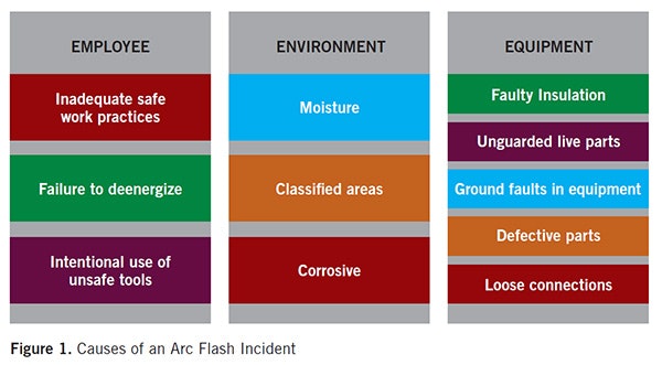

In this ever-changing world we live in, the demand for high-efficiency electrical equipment is steadily increasing. With more electrical equipment to maintain and operate, workers are exposed to numerous hazards every day. One of those hazards is arc flash, or an arc blast, which can have devastating consequences. If there is an incident, the emotional and financial effects can be devastating. As illustrated in Figure 1, when you start to combine individual arc flash risks, you significantly increase the chances of an arc flash event.
In the United States, OSHA 1910.132 requires employers to access the workplace to determine whether hazards do or are likely to exist. OSHA references the National Electrical Code, NFPA 70E, and the IEEE standards for compliancy.
A common cause of noncompliancy is the misuse of the PPE tables in NFPA 70E. It’s often overlooked that NFPA 70E requires the available fault current and clearing time of protective devices to be known; in many plants, this is not the case. Also, NFPA 70E states that an incident energy analysis is to be performed when the following conditions are present:
