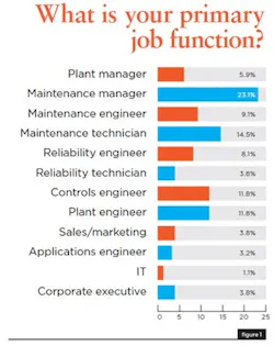

The survey was open from Oct.-Dec. 2017 and attracted nearly 200 responses from Plant Services readers. Figure 1 illustrate the types of jobs that survey respondents hold, and Figures 2 and 3 show their levels of electrical expertise and the types of industry certifications they hold, respectively. Other questions asked where you fit generationally (about half of respondents are Boomers and older, and half are Gen X and Millennial); the size of your maintenance/reliability team (about half were between 5-50 people); and the number of plants your organization manages (close to 70% of respondents work for organizations of five plants or fewer).
