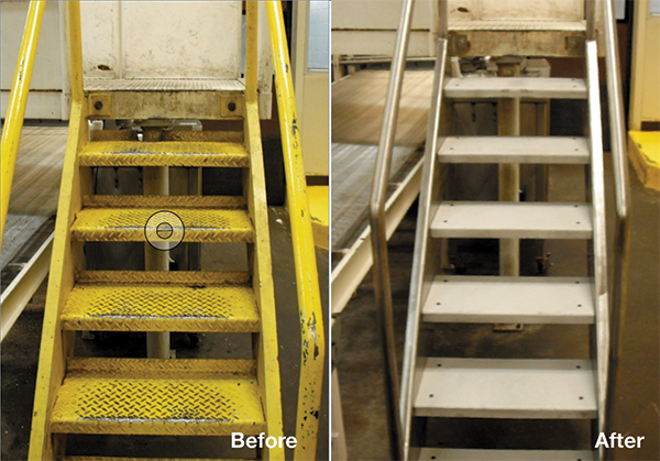

- Observe which materials are being used. Diamond plate is easy to fabricate and relatively durable. Unfortunately, it is commonly mistaken for a slip-resistant product and loses any non-slip properties when wet or exposed to dust particles, increasing the odds of a slip and fall injury.
- Are there trip hazards on elevated areas, such as neoprene mats that can roll up or change the walking surface? Installing high-traction walking surfaces eliminates the need for mats.
- Do stairs have high-friction treatments on the nosing and the hand railings? Both should be anti-slip to ensure safety (see Figure 1).
Figure 1. Stairs can be retrofit to increase their anti-slip properties. To maximize safety on stairs, apply high-friction treatment on the nosing and the handrails.
