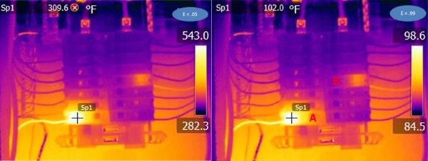

I never use the word “camera” when referring to an infrared imager. A “camera” is a consumer item which can be bought at any big-box store. Cameras employ “point-and-shoot” technology and are simple and easy to use. While modern imagers come in a form factor very similar to cameras, that is where the similarities end. It may be true that almost anyone can pick up an imager up and record an image, will it be a useful image? A common misconception with thermography is that infrared imagers measure the temperature of an object. They do not. Every object in nature emits varying amounts of infrared radiation. The amount of radiation emitted will be influenced by object temperature, surface condition, target shape, and viewing angle. This is called emissivity. Human skin emits infrared radiation at a very high level, while shiny metals such as copper emit very little. An object can also reflect the infrared energy from its surroundings. This is called reflectivity. Emissivity and reflectivity are linked. Objects with high emissivity have low reflectivity, and vice versa. The thermographer must enter the correct emittance of an object into the imager in order to get an accurate temperature. Other variables that must be considered include ambient air temperature, humidity, and distance to the target. So the imager can be used to show qualitative thermal differences in an object. In other words, the trained thermographer is able to detect thermal patterns in an object and determine when an anomaly exists. Remember reflectivity? A lot of electrical equipment is metal and is highly reflective of infrared radiation. The component being imaged can even reflect the thermographer’s own body heat and an inexperienced or untrained thermographer can mistake that reading as the temperature of the component. And detecting a hot spot isn’t the only issue. Is the increased heat due to a loose connection? Or is the circuit overloaded? These separate anomalies have their own characteristics, and a trained thermographer can tell the difference without first sticking a screwdriver into an energized panel to check for connection tightness (Figure 1). And some types of breakers are designed to operate at a particular temperature, which may be elevated compared to the other types of breakers in the same panel.
Paragraph 11.17.1 of NFPA 70B states, “Infrared inspections of electrical systems are beneficial to reduce the number of costly and catastrophic equipment failures and unscheduled plant shutdowns.” The use of thermography to perform surveys of electrical equipment is not only validated by NFPA 70B, but it is also recommended. It is also recommended that the personnel conducting thermographic surveys be “qualified and trained personnel who have an understanding of infrared technology.” Engaging a trained and certified thermographer can prevent possible errors and mistakes during imaging and interpreting data (Figure 2). It is highly recommended that a level-III certified thermographer take part in the design, implementation, and oversight of the plant’s IR predictive maintenance program. Level II should be considered the minimum level of certification for an individual imaging electrical equipment. A Level-II certified thermographer is qualified to interpret and evaluate the results of imaging with respect to applicable codes, procedures, and specifications, as well as properly calibrate imaging equipment. Many applications of IR thermography are qualitative in nature, and Level-I thermographers are able to perform those tasks. However, the imaging of electrical equipment involves the more advanced knowledge and experience of a Level-II thermographer in order to record accurate quantitative data. Utilizing properly trained personnel reduces liability while increasing the credibility of the program.
Figure 2. In the image to the left, the emissivity is placed at a very low setting to show how the imager interprets the input variables. At right, te same image is shown with the emissivity set to 0.99. Notice the change in temperature. Without all variables being known and taken into account, the exact temperature will not be known. But the image is still qualitative and an experienced thermographer is able to interpret the image for useful information without the temperature reading. The breaker at “A” is rated for 15 A and is currently loaded at 9.7 A (65% of capacity). The breaker at “B” is rated for 20 A and is currently loaded at 7.6 A (38% of capacity). The infrared condition of the wire tells the story. No amount of tightening will change the condition of the fuse. The loading on Circuit "A" is above optimum
