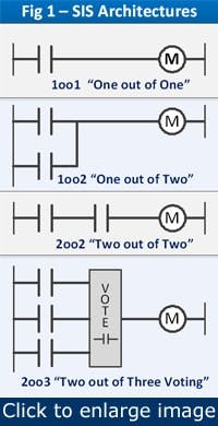

Although using only a single control device often is appropriate, much of safety instrumented system (SIS) design incorporates multiple devices to perform a single control function. The multiple units are cleverly arranged to accommodate the anticipated failure of any single device. Although formal terms such as replicated, complementary or diverse aptly apply to the various arrangements, the catchall term “redundant” is normally used to describe any flavor of multiple-device configuration.
The SIS concept uses an “M out of N” terminology to describe device configuration; reliability is based on M number of properly functioning components out of a total of N. This concept often is noted as MooN (spoken as “M out of N”). For example, 1oo2 (“one out of two”) might represent an arrangement of two relays in series; depending on context, this arrangement can safely shut down a process with only one of the two devices, or it can continue safe operation with only one of two. The terminology for each context is the same, but the applications are quite different. Further examples of typical SIS architectures include:
  • 1oo1: A single fuse or rupture disk that limits an over-current or over-pressure malfunction in a near infallible mode.
  • 1oo2: Two power supplies connected in parallel to accommodate shutdown of either one. Only “one out of two” is required for continued safe operation.
  • 2oo2: Two high-level sensors connected in series that permit a tank inlet valve to open. “Two out of two” devices, both indicating there is no high level, are required to safely open the valve.
  • 2oo3: Triple modular redundant (TMR) pressure transmitters configured in a voting system. “Two out of three” devices must agree to continue safe production should one of the three transmitters fail in any manner.
Figure 1. These relay contact motor control schemes show how the degree of reliability desired determines the degree of complexity needed in the control system.
Note that each of these examples addresses a specific malfunction of a control device. This important concept will be explored a bit more later on. Figure 1 illustrates four examples of increasingly complex SIS architectures; all are based on simple relay contact motor control.
