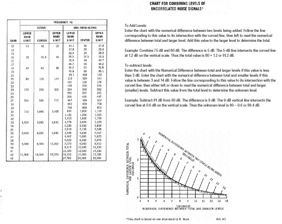

Figure 2. This chart is used for combining uncorrelated noise signals.
Another important consideration for determining compliance is additive noises. In most plants, workers are subjected to noise from multiple sources. This means the individual sound levels need to be combined into a single value. The chart in Figure 2 can help with the mathematics of sound addition. Assume that a plant has four gear motors that generate equal amounts of sound energy yielding a total of 94 dB “A” and the plan is to quiet things down a bit.
To cut the noise to 91 dB “A,” two of the gear motors would have to be turned off. To get below the OSHA limit of 90 dB “A,” a third gear motor would have to shut down, leaving one gear motor that produces about 88 dB “A.” In the real world, it might not make sense to shut down production equipment just to meet the regulations. That’s why it’s important to understand how sound levels can be reduced without affecting production operations.
