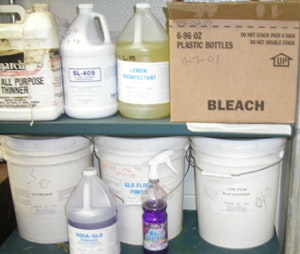

While it’s chemical-resistant and durable, epoxy grout must be treated with the same realistic respect as any other material. Believing that turning the mop bucket over to an untrained janitorial staff and the all-purpose handy floor cleaners stored in the janitor’s closet (Figure 2) isn’t going to affect the grout is unrealistic. That’s why unjustified product expectations outweigh the actual performance.

Many maintenance environments, not just food service, abuse the floor covering system continually, which generates “under-performance” issues such as using the floor before the grout has a chance to cure completely, mixing non-compatible cleaning chemicals, using any type of so-called all-purpose floor cleaners, improper cleaning solution dilution ratios and inadequate floor rinsing results in cleaning chemical build-up.
To make matters worse, using hot water on epoxy grout can soften the grout, allowing it to be scrubbed out of the joint. Exposure to chemicals that are highly caustic to epoxies (such as certain non-rinse enzyme floor cleaners) and mixing different cleaning chemicals can result in high concentrations of solvents that prematurely degrade epoxy grouts. Because of repeated poor maintenance practices and the damage it causes to the grout, various associated members of the cleaning, maintenance and floor covering industries continue to study the matter to help solve this problem.
Figure 2
Different flooring surfaces require different cleaners. Caution: Mixing certain cleaning agents can release chlorine gas.
