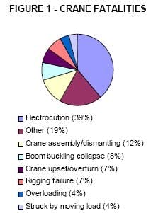

The leading causes of crane-related fatalities based on data from a 1996 analysis of 502 crane-related incidents (Suruda, Egger, and Liu) are provided in Figure 1.
A separate study involving a review of 158 crane-related incidents from 1997 to 1999 identified the most frequent causes of mobile crane incidents to be instability (e.g., unsecured load, load capacity exceeded, ground not level or too soft, etc.), lack of communication, and electrical contract.   However, “people do not plan to fail, they fail to plan.”  As a result, less-than-adequate mobile crane lift planning encompasses most, if not all, of the above causal factor categories.  Therefore, establishing criteria for “critical lifts,” preparing formal lift plans, and utilizing lift planning checklists are important components in preventing mobile crane failures.

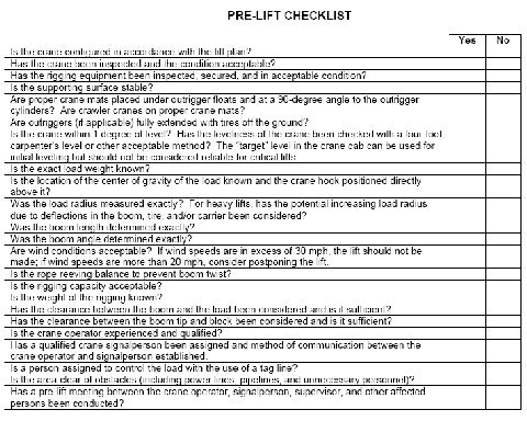

Pre-lift checklist
There are many factors that affect a crane’s rated capacity.  Therefore, it is generally a good practice to use a pre-lift checklist when planning a lift and for site personnel to also use just prior to executing the lift to ensure that those conditions that may affect the crane’s rated capacity have been considered.  If a lift cannot be made under the configuration and conditions specified in the lift plan, the lift should be re-evaluated and approved by a qualified person.
In summary, formal written lift plans should be required for all “critical lifts” as defined by your organization in order to prevent high profile incidents with the potential to cause devastating damage, injuries, and unfavorable publicity for your company.
