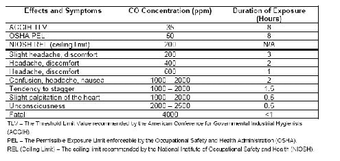

CO enters the body by inhalation and interferes with the blood’s ability to carry oxygen.  CO readily combines with hemoglobin in the red blood cells to form carboxyhemoglobin (COHb).  Excessive accumulations of COHb cause hypoxic stress in healthy individuals as a result of the reduced oxygen-carrying capacity of the blood.  In individuals with cardiovascular disease, such stress can further impair cardiovascular function.  Loss of consciousness begins when the worker’s COHb level approaches 50%, and prolonged exposure can result in death.  Other target organs of CO exposure include the central nervous system and the reproductive system.
The health effects and symptoms of CO exposure are based on the concentration and duration of exposure and are provided below:
Click table to enlarge
