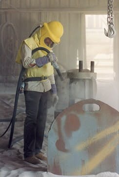

Abrasive blasting
Abrasive blasting operations commonly use sand to clean iron and steel surfaces, brick, stone, concrete, sand castings, aluminum, brass, copper, wood, glass and plastic. Silica dust (SiO2) is produced when sand is used as the abrasive material. Of special concern is dust from pulverized surface coatings, encrusted materials and substrates. In terms of worker health, though, silica dust is of major concern because it may cause silicosis, a lung disease that develops slowly and often leads to death years after exposure has ceased (see Figure 1).
Figure 1. Abrasive blasting can produce silica dust, which, if inhaled, can lead to silicosis.
