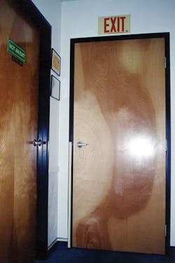

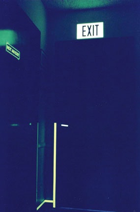

Photoluminescent emergency lighting kicks into action during power failures or fires.

When the lights go out, safety markings define the best escape route.

The standard guide describes recommended uses with informative drawings highlighting the installation of photoluminescent safety markings. The markings are typically located low, either directly on the floor or on the wall within eight inches of the floor. During a building fire, smoke accumulates under the ceiling and quickly obscures electrical lighting. Building occupants are forced to crawl below a layer of heavy smoke. Photoluminescent lighting in low locations outlines the escape path. The floor markings may be anti-skid tape, epoxy floor paint or durable floor inserts that resist the wear and tear of foot traffic.
To avoid injuries, obstacles and protrusions are marked with a glowing warning tape, acrylic wall paint or cushioned bumper guards. Exit doorframes are outlined with tape or paint. Photoluminescent material is placed on or behind the exit door handle to avoid searching for the door's opening device. One photoluminescent exit sign should be installed above the door to be visible during clear air evacuation. A second exit sign should be in a low location to be visible underneath a smoke layer.
