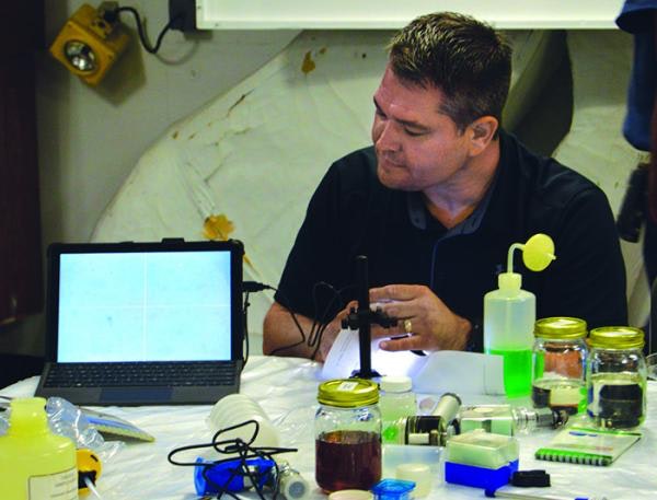

Finally, if you want to add some technology, purchase an inexpensive microscope to have in your tool box. With this and your laptop, you can get up close and personal with your contaminants (see Figure 1), including checking out your new, clean oil, which is usually not very clean at all and should be filtered before use.
Figure 1. The author demonstrates the microscope technique during a training session aboard the USS Yorktown at Patriots Point in South Carolina.
