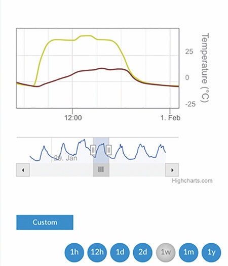

A properly deployed and acted upon IIoT system for PdM can provide great benefits. Consider a case where an IIoT system was deployed in an outdoor rock-crushing operation during winter. This plant had experienced several unexpected failures of critical motors and gearboxes driving a conveyer belt, leading to a complete plant shutdown for days. Sensors measuring vibration and temperature were deployed on the critical motors, bearings, and gearboxes. To minimize the costs and the amount of data collected on the motor, only the drive end bearings were monitored. An initial data collection rate of once an hour was implemented.
A review of the baseline data collected after just a few days indicated that the daily temperature variation (Figure 1) of one of the gearboxes (left side of the conveyer belt) was much greater than that of another identical gearbox (right side of the conveyer belt). The data clearly indicated that there was unbalanced loading in the system and that the gearbox with the higher temperature was likely to fail soon.
The IIoT system alerted plant maintenance and provided the necessary insights into the root cause. The steady increase in temperature over time provided the plant with foresight into the rate of deterioration and expected life of the gearbox. As a result, they were able to purchase a spare gearbox in time at a reasonable cost (no rush charges), and when the overloaded gearbox failed, were able to replace it and correct the issue within two hours, leading to avoidance of lengthy downtime.
