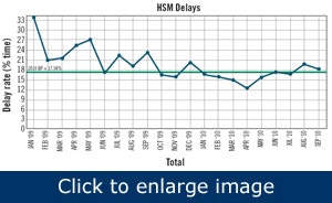

The average production equipment delay rate in 2008 and 2009 was more than 20%, with 2009 averaging 22% delay rate, or 78% working ratio. Since starting the
WCER in the HSM, the average delay rate for 2010 has dropped to 18%, which is a working ratio of 82%. Though this improvement hasn’t translated into additional profit yet because of current economic conditions, it resulted in significant gas and electric energy savings in the amount of $400,000 year to date. Once economic conditions improve and markets return, the increased working ratio will deliver a greater profit to the organization through increased production capability.
