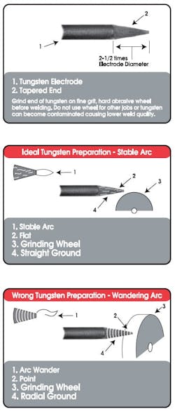

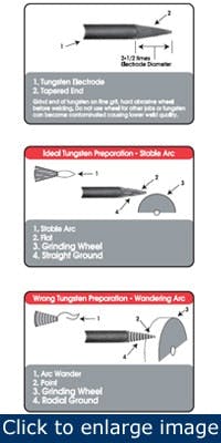

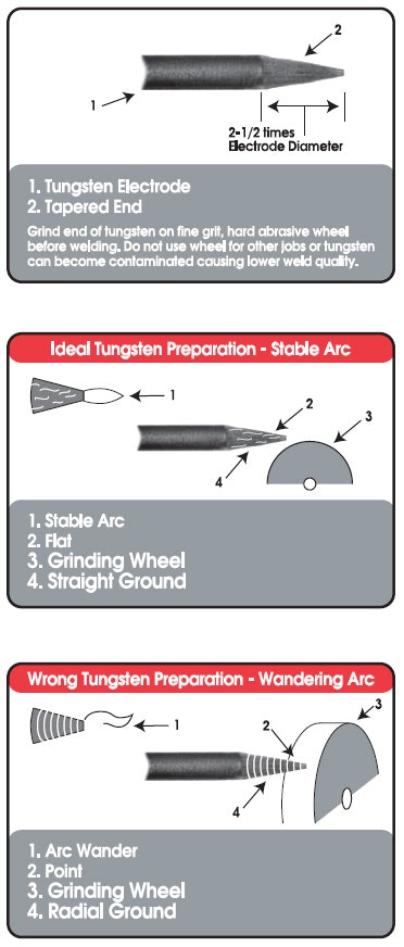

The type of tungsten you select depends on the kind of power source you are using, as well as the material you are welding, but it can have a significant impact on your efficiency. So can the shape of the tungsten.
Figure 1: To achieve this shape (and to prevent contamination or arc wandering) grind the tungsten on a borazon or diamond grinding wheel specially designated for the purpos.
For AC and DC welding using an inverter, a pointed and/or truncated tip (for ceriated, lanthanated and thoriated tungsten) provides the stable arc needed to achieve good welding performance and quality. To achieve this shape (and to prevent contamination or arc wandering) grind the tungsten on a borazon or diamond grinding wheel specially designated for the purpose (see Figure 1). Next, grind the taper on the tungsten to a distance of no more than 2.5 times the electrode diameter (for example, with a 1/8-inch electrode, you would grind a surface 1/4 to 5/16 inches long), as this eases arc starting and helps creates a more focused arc.
When welding with lower amperage on thinner materials (those ranging from .005 to .040 inches), it is best to grind the tungsten to a point. A pointed tungsten allows the welding current to transfer in a focused arc and helps prevent distortion. Pointed ceriated tungsten, in particular, works well when welding aluminum, as it provides 30 to 40% more amperage capacity than pure tungsten before it begins to melt. Do not use a balled tungsten for such an application.
On higher current applications, grinding the tungsten to a truncated tip can help with your welding performance by preventing the tungsten from balling. First, grind the tungsten to a taper as explained above. Then grind a .010- to .030-inch flat land on the end of the tungsten. (Note: If you are grinding thoriated tungsten, make sure you control and collect the dust, have an adequate ventilation system at the grinding station, and that you follow manufacture’s warnings, instructions and MSDS.)
