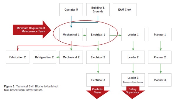

In Figure 1, you can see our technical skill blocks. This is how we have grouped competencies required for many of the required roles within the facility. The Mech1 skills block is the entry point as a technician. There are qualifying roles that would allow an employee outside the maintenance department to apply for a maintenance role starting at the Mech1 skills block; an Operator 5 level is an example.
A person who has reached qualification for an Operator 5 role has specific basic skills of a maintenance technician. We’ve taught that person about safety and operations and the use of certain hand tools. The person would have been performing specific PMs, and higher-level PMs than other operators on the floor. For the building and grounds folks, they’ve been working on lighting systems, for example. Mechanical and electrical prequalifiers are the basics for anybody coming onto the team, and progressing upward means acquiring additional mechanical and electrical skills. And once we attach a dollar wage to an entry point, the rest of these blocks add up to increase the employee’s wage, minus standard cost-of-living increases.
For the sake of easy math, let’s say that a Mechanical Level 1 position starts at $20 per hour. Any of the Level 1 skills that this person picks up would be worth a dollar per hour more. Adding the Electrical 1 skill block would lift the person to $21 per hour.
Jumps to Level 2 and Level 3 are worth an additional $3 per hour. A person who has the Mechanical 1, Electrical 1, and Electrical 2 skill blocks would earn $24 per hour. This provides a path for growth in our technical teams from the shop floor and onward into leadership roles. With clearly defined entry points to each level, it allows us to be consistent in compensation both for current employees who are acquiring new skills and with new hires who are coming through the door.
For a refrigeration tech, the required skill blocks are M1, E1, and M2. The salary progression would be $20 per hour to $21, $24, and then $27. The compensation-setting process becomes very objective, and we can plan the business around what we think are the skills required to run a facility. For example, we need two fabricators, or we need three refrigeration techs, or all shift mechanics must be an M1. We can more effectively formulate our current team and better create positions we will need that people can grow into.
Defining the skills blocks content has been a large undertaking, and we are still completing this work. We have defined several to date – M1, M2, E1, E2 – and we have Lead levels 1, 2, and 3 built. Also, we have Planner 1, Planner 2, and Fabricator.
