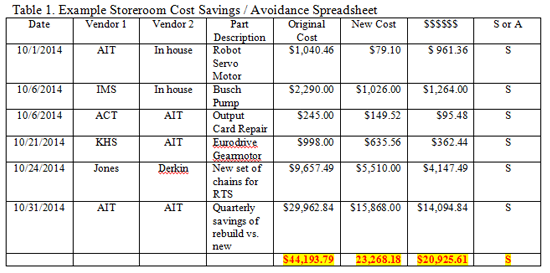

Savings-avoidance log
Cost savings is a bit easier to capture than cost avoidance. I give my buyer and planner/scheduler a spreadsheet as shown in Table 1, with a few columns delineating, for example, vendor 1, vendor 2, part description, old cost, new cost, cost savings or cost avoidance, etc. An updated spreadsheet gets turned in to me on a monthly basis, and I share the savings with the leadership group. (In-house vs. third-party rebuilds contribute to cost savings as well.)
Cost avoidances are a bit different. When you talk vendors out of price hikes, that's easy to capture. Make sure your buyer captures these on the spreadsheet, too.
The hard thing to capture is failure prevention. Find out your replacement asset values, your maintenance cost per unit produced, the total cost of downtime with overhead figured in (remember, total cost of downtime per line). Illustrate what a 1% improvement in overall equipment effectiveness (OEE) is worth in profit. Also, find out how long failures normally last. If you use your CMMS/EAM system properly, you should have this information. If you do not, good luck –you will have to do it all manually.
