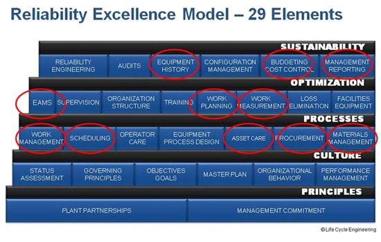

The REX Model
The REX Model used by the consultant we employed, Life Cycle Engineering, emphasized the importance of planning, kitting, and scheduling in 11 of its 29 elements (Figure 2).
Figure 2. The REX Model was implemented at Alcoa Warrick Smelter by Life Cycle Engineering.
These 13 aspects are what Alcoa considers best practice for the planning and scheduling process. Although not shared here, for each of these 13 aspects, we have articulated a minimum acceptable standard and also what we believe is a best practice level of operation.
